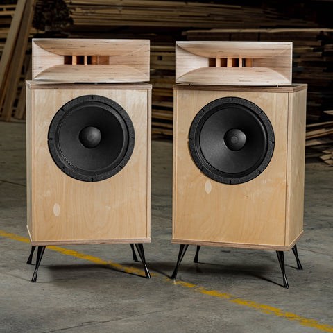

Alnico, Titanium nitride ceramic, veneer core joinery, stacked Birch laminate horn, foil inductors, alloy cabinet parts. Classic down-ported bass reflex in 135 liters.

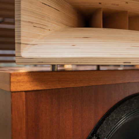

Baltic Birch horns are solid fine-ply laminate and clear-finished. Horns and/or cabinets may be stained for a fee. Contact us for this and other options.

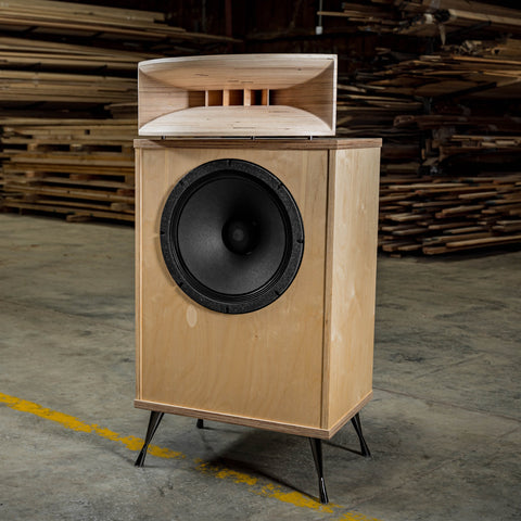

  • 16" GPA Altec 515 replica Alnico bass driver with cellulose cone and flat wire underhung voice coil for superb definition.
  • 400Hz 90x40 degree laminated Baltic Birch broadcast-style top horn. 1.4" compression driver with nitrided titanium diaphragm, proprietary phase plug, edge-wound high temperature voice coil, ellipsoidal suspension.
  • Fine natural all-veneer cabinet. Computer-machined and hand-assembled in Upstate South Carolina. Cabinets and horns are finished in a hard, catalyzed semi-gloss lacquer.
  • Reinforced 18mm and 25mm veneer laminate plywood casework with constrained, damped internal driver board. Extensive four-ply viscous acoustical and vibration control measures on all interior surfaces. Natural fiber acoustical lining.
  • Optimally tuned reflex alignment for superb bass and extension. Down-firing.

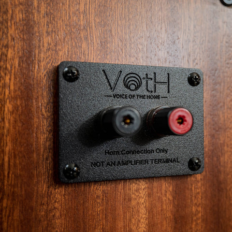

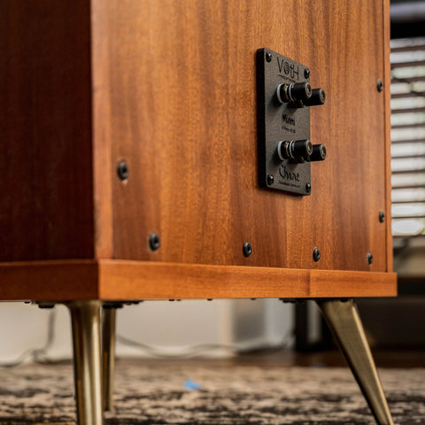

  • Premium quality biwired input terminals and matching output plate to horn driver terminals. Easy plug-in setup.

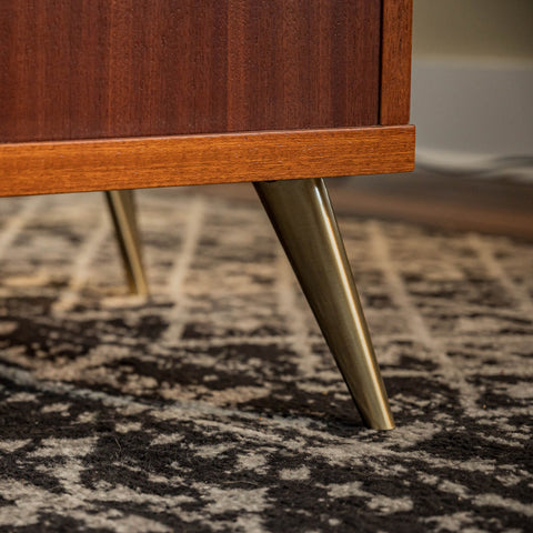

  • Miami ships with 6" solid metal legs installed.
